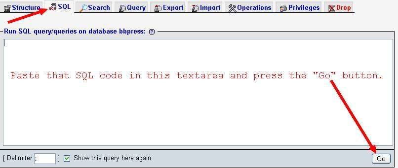

1. Go to cPanel and create the database with name 'template_blocks'. If database is created proceed, to next step.
2. Go to phpMyAdmin and select the database that you just created.
3. Click on the 'SQL' tab.(refer to below figure)
4. Paste the below lines into the above shown textarea and hit 'go':
Note: I am not sure how it would work because variable 'TABLE_PREFIX' is not declared. To solve this issue, use the 'Find and replace function'. Replace '{{TABLE_PREFIX}}' with prefix of your choice or leave it blank.
Also I am doubtful about the last character in this code. Looks like some character encoding related problem to me. Please check that again.

You mean I have to paste the whole contents into the SQL tab? The contents of the text file are the commands itself?
OK. I will try it. Thanks.
blackpearl is offline
Old 09-05-2008, 09:09 PM   #4 (permalink)
हॉर्न ओके प्लीज़
victor_rambo's Avatar
Posts: 1,493
Default Re: Need help in creating table in Mysql
yes, they are the SQL commands. Give it a shot!
And don't the entire file., Paste only the code that I have quoted above.
